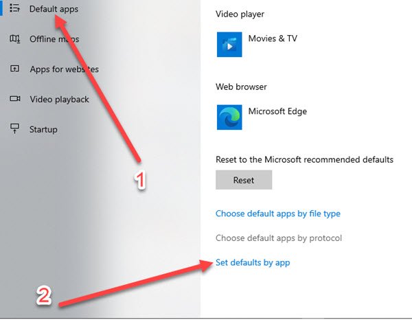

2] Set Excel file associations to default
Resetting file associations is not difficult, so let’s look at how we can get this done with ease.
OK, so we need to fire up the Settings area by clicking on the Windows key + I.
Once the Settings app is up and running, select Apps from the menu, then navigate to Default Apps > Set defaults by app. From there, click on Excel and decide the associations.
You should now see the search process attempting to find your programs. Once you see Excel on the list, select it then click on Choose default for this program.
From there, the association screen will appear, so when it does, please click on Select All > Save > OK, and that’s it.
