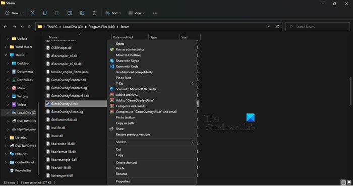

7] Reinstall Steam
If nothing works, then you need to reinstall Steam and see if that helps. Before uninstalling the app, we need to delete GameOverlayUI.exe. Open File Explorer and go to the following location.
C:\Program Files (x86)\Steam
Then, right-click GameOverlayUI.exe and select Delete. Now, uninstall Steam and download a fresh copy from store.steampowered.com. Now, install the app, and hopefully, this will do the trick for you.
