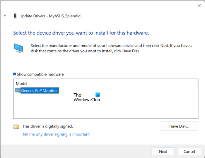

3] Install the Generic Monitor driver
If the above fix did not help, replacing the monitor driver with the Generic Monitor driver for your external display can help. Go through the following instructions:
- Open the Device Manager.
- Expand the Monitors branch.
- Right-click on your monitor driver and select Update driver.
- Select Browse my computer for drivers.
- Now, select Let me pick from a list of available drivers on my computer.
- Select the Show compatible hardware checkbox.
- Select the Generic PnP Monitor driver from the list of available drivers.
- Click Next and follow the on-screen instructions.
Did it help?
