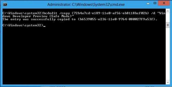

To enable the F8 keep, so that we can use it to start Windows 10/8 in safe mode, open an elevated command prompt window. Type the following and hit Enter:
bcdedit /set {default} bootmenupolicy legacy
You will see a message: The operation completed successfully.
You will find that the Windows 8 F8 key which was not working, is now working! You may have to restart your computer to get the setting to work.
