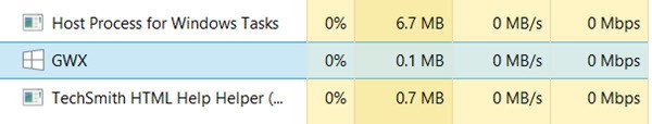

The process that is responsible for this icon is called GWX.exe, and it runs in the background, consuming near-nil resources. It will inform you as soon as your upgrade is available to be installed.

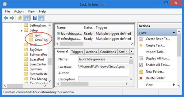

This process autostarts, as it is a scheduled task and you can see it in your Task Scheduler too.

Some also suggest removing the gwx and GWXTriggers tasks from the Task Scheduler. Others recommend using a BAT file to remove the icon.
