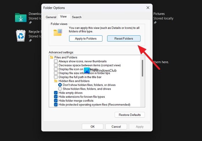

1] Reset Folder settings
If there is an issue that we don’t know of yet on our PC that interferes with File Explorer, you might see this issue occur. You need to reset the Folder settings to fix that.
- Open File Explorer and click on the three-dot button in the Menu bar
- Select Options
- Then, click on the View tab
- Click on the Reset Folders button under the Folder views section
- Select Yes on the prompt
See if it has fixed the issue.

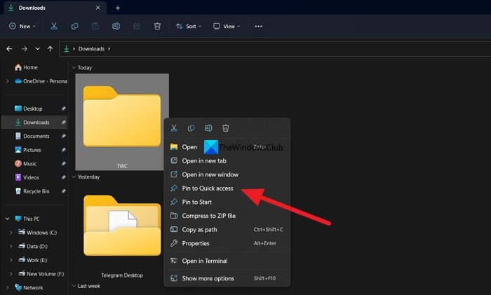

2] Manually Pin the folders
After you have reset the Folder settings, you can now manually pin the folders you regularly use to the Quick access menu. The pins you create now might not get deleted or go missing if they were deleted with an error in Folder settings.
To manually pin the folders to the Quick access menu, Right-click on the folder you want to pin and select Pin to Quick access.
