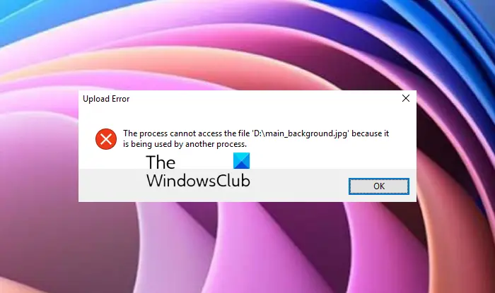

It’s a known fact that if a file is already in use, it cannot be modified by another process. In this scenario, when a program or process opens a file, the OS puts a lock on it, and if another program tries to modify it, it will not be allowed. This post will help you resolve the error where The process cannot access the file because it is being used by another process.
Now that you know why the program cannot access the file, it is time to figure out which process has already put a lock on them. The error could appear in any program like Visual Studio, Outlook, Windows Update, Photos App, Java, etc.
Before you read on, we recommend you restart your computer and then see if this makes the error go away.

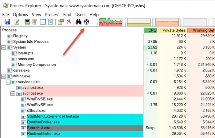

If you do not want to restart, then to find out the lock, you will need to use Sysinternal Suite’s Process Explorer.
Launch the Process Explorer program and locate the icon that says, “Find Windows Process.” Drag the icon and drop it on the file, and it will instantly reveal the process.
Please right-click on the process and kill it.
Now, when you try to access the file with your program, it will not throw any error.
