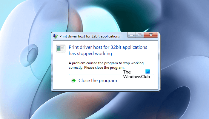

This article lists the possible solutions to fix the error Print driver host for 32bit applications has stopped working on a Windows computer. This error usually occurs on the older versions of Windows operating systems that use 32bit printer drivers. If you see this error on your system, you can try the solutions provided in this post.
How do I fix the Print driver host for 32bit applications has stopped working?
This is a driver-related error. Therefore, you can fix this by updating your printer driver from the Device Manager. Apart from that, the error message can also occur if the Print Spooler service has stopped working. Therefore, another solution to this problem is restarting the Print Spooler service.
The following solutions may help you get rid of the error “Print driver host for 32bit applications has stopped working.”
