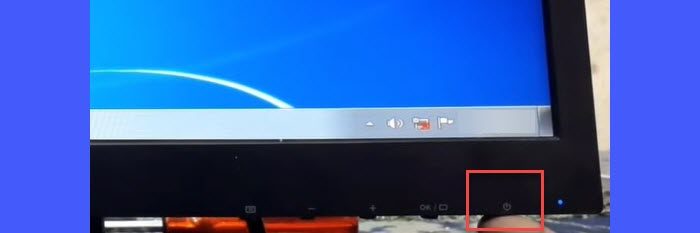

1] Check if the power button is stuck
Press the power button to see if it is stuck or if something is pressing against it. If you suspect that the buttons have become greasy or dirty, completely disconnect the monitor from the VGA, power cable, and other peripherals and turn it upside down. Then, use an all-purpose cleaner to clean the buttons.
Next, press the buttons repeatedly for a few seconds, wipe them, and allow them to dry out completely. Re-connect everything and see if it fixes the problem.
2] Disable the Power Button Lockout function
In most LCD/LED monitors, holding down the Power button or Menu button for around 10 seconds locks out the functionality of that button. If you’ve inadvertently pressed the Power button for too long, you might have activated the power button lockout.
To restore the functionality of the Power button, press and hold it down for about 10 seconds and wait for the ‘Power Button Lockout’ message to disappear.
To restore the functionality of the Menu button, press and hold it down for about 10 seconds and wait for the ‘OSD Lockout’ message to disappear.

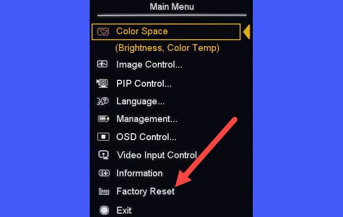

3] Reset the monitor to factory settings
If the Power button is locked but you can access the on-screen display (OSD) menu, you may try resetting your monitor to factory settings and see if it works. While the steps may vary depending on the specific monitor model you have, here are the general instructions to factory reset an HP monitor:
- Press the Menu button to open the OSD menu.
- Once in the OSD menu, navigate through the options using the arrow keys or similar controls.
- Select the option that says ‘Factory Reset‘ or something similar.
- Select Yes to confirm your action. The process may take a while after which the monitor will restart with factory settings.
If the Power button and the on-screen display (OSD) menu are both locked, try doing a hard reset. Disconnect all cables (HDMI, DisplayPort, etc.) and the monitor’s power cord. Hold down the power button for 30-60 seconds to clear any residual power in the circuits. Reconnect the cables and the power cord and turn on the monitor.
