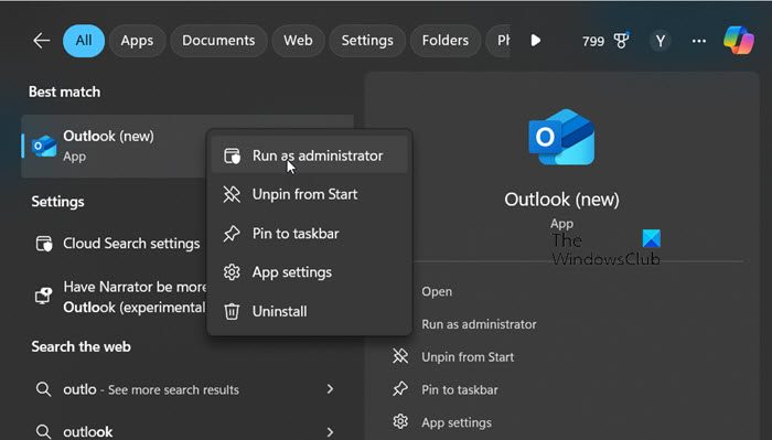

1] Run Outlook with admin rights
Run Outlook (new) with admin rights and see. Go to the Search bar and type Outlook. Right-click on it and select the Run as administrator option. Click Yes when the UAC prompt appears, and then see if the issue is resolved.

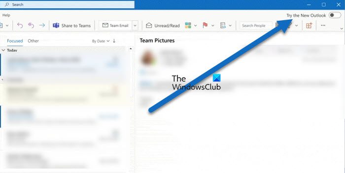

2] Switch to classic Outlook
If you face this issue when opening Outlook (new), we recommend you switch to the older version. To do so, turn off the toggle that says Try the new Outlook or New Outlook. This might take some time, so reset it. If you don’t see the option, you can search Outlook from the Start Menu and then open Outlook or Outlook (classic).
You may use Outlook (classic) in this case.
