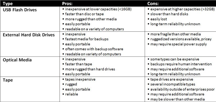

In order to back up data from your computer, you will need two things, hardware, and software.
The hard side…
So, with that in mind, what options are available to back up and restore your data in the event of a computer emergency? Well, a typical backup solution consists of both hardware and software, so let’s take a look at the different types of hardware with the following chart before we go into further detail.
USB flash drives are the newest medium available, ranging in size from under one gigabyte to at least 256GB, although you can expect to pay a hefty premium for larger sizes. The main advantage of USB flash drives is their size: They easily fit in a pocket or a keychain, and can be kept just about anywhere. Of course, the disadvantage of this is that they occasionally end up going through the laundry. One concern about the medium is how reliable they will be over time. Some manufacturers offer lifetime or ten-year guarantees on their flash drives, but these only apply to the drive itself, and not to any data you may have stored on it. Also, like discs and tapes, you can periodically buy several flash drives inexpensively and copy your data to them, reducing the likelihood of total data loss in the event of one failing. If you do not have a lot of files to back up, USB flash drives are the obvious choice.
External hard disk drive systems have been around for many years, originally as proprietary systems which required specialized interfaces and cabling, evolving to the common external hard disk drives available today. Current systems place a 2.5” (notebook) or 3.5” in an enclosure, with USB, FireWire and eSATA connectors for attachment to a computer. External hard disk drives systems based on the 2.5” hard disk drives used in notebooks are physically smaller than those using 3.5” hard disk drives installed in desktop computers. They often store less information and are not as fast as their larger counterparts, but make up for it in portability—some as small as a deck of playing cards—and often require just a single cable to provide both power and data to their host computer. External hard disk drive systems based on 3.5” hard disk drives are often less expensive and faster than their smaller brethren, but larger (about the size of a hardback book) and always require an external power supply adapter, since desktop 3.5” hard disk drives require additional electricity.
When purchasing an external hard disk drive, I would recommend looking at the warranty, keeping in mind that warranties only cover the failure of the device itself and not the recovery of any data stored on them. Also, check what type of connections it has for both data and, if applicable, power. USB connections are recommended because they are the most common; however, purchasing an external hard disk drive enclosure with several types of connections will give you some flexibility, in the event that the computer to which you are restoring your data does not have a USB connection available. If an external hard disk drive enclosure requires an external power source, I recommend buying one that uses a standard “barrel” connector for its power jack, as opposed to the proprietary multi-pin connectors used with some external hard disk drives. In the event that you lose—or are forced to leave behind—your external power supply, a standard power source will be easier to replace.
There are a variety of sizes and formats of optical discs, but the most common are CD’s, which hold 650MB and DVD’s, which hold up to 4.7GB per side. Both recordable CD and DVD formats include discs which can be written to once (CD-R and DVD±R) and/or multiple times (CD-RW, DVD±RW, and DVD-RAM). I would recommend avoiding the reusable “RW” discs, since they can be written a finite number of times, after which they lose the ability to retain (re)written data. The DVD-RAM format handles rewriting better but uses special optical discs that may be more difficult to find and expensive. The 650MB stored on a recordable CD may seem very small these days, but they are inexpensive, and a single CD might hold several years’ worth of correspondence and documents like tax records. Recordable DVDs hold about seven times as much data as a CD. While individual CDs and DVDs may be too small to backup your computer’s hard disk drive, backup programs allow you to back it up across a set of discs; we’ll talk more about backup software later. You will still need to swap discs in and out of your CD/DVD drive as you record your backup to them. Recordable Blu-ray discs are also currently available in capacities up to 50GB. However, both Blu-Ray disc recording drives and the media they use are expensive and may be difficult to find. One concern about early recordable optical discs is that they may degrade over time, due to either latent manufacturing defects and/or the composition of their materials. Check with your disc vendor to make sure the discs you purchase for use are archival quality.
The Tape is the oldest backup medium, with usage dating back about half a century. As such, it has arguably withstood the test of time, although proper storage of both media and the equipment to read them becomes an issue. Today’s tape backup systems store from tens to hundreds of gigabytes of data—and even more with compression—and are highly reliable, which is one reason they are still used. A tape backup system is expensive, though, with tape drives running from the hundreds to thousands of dollars, and individual backup tapes in the tens to hundreds of dollars range. The tape is no longer widely used as a backup medium on the desktop, but it is still used in the enterprise, where the costs of maintaining tape drives and storing backup tapes are less of a concern. Tape might fill a niche for some, though.

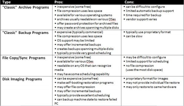

Just as there are several different types of devices to back your data up to, there are several different types of programs with which to back your data up to those devices. Although there has been a lot of consolidation over the past few years and the lines between types of the program have blurred, they can still be classified by what features they originally started with, since that is where they will be strongest, performance- and feature-wise.
Our Data, Our Selves: A Guest Post & Whitepaper on Data Backup
Let’s take a look at the most common types now:
Archives are not just for scholars
Classic archive programs are normally used to compress a large infrequently-used file into a smaller one, or to store a collection of several files in one compressed “container.” This is usually done to transfer files over slow network connections or to use less media when copying files to a disk for transport. The archived file(s) can then be expanded on arrival. However, these same benefits of reducing the size of files for transport make archive programs useful for backing up files. Archive programs compress files to the smallest size possible according to the compression algorithm used, so that the resulting archive(s) use up the least amount of space.
Archive programs tend to use standardized formats such as .7z, .RAR and .ZIP, can often open archives created by each other and, increasingly, create archives in each other’s native formats. Most other types of backup programs do offer some sort of file compression feature to reduce the amount of space required for a backup, but they typically do not do as good a job as dedicated archiving programs, resulting in backups which use up more space. Many archive programs allow you to password-protect their archive files, so they cannot be viewed or opened without first entering the password. One concern about using an archive program for backing up your files is that while they may technically be capable of doing so, they are not typically designed for this use. In the event of an error with your backup archive, the program’s technical support may be of limited assistance in repairing very large archive files.
Like their archive program counterparts, “classic” backup programs are designed to store many files inside of one file using some form of compression, although some may not use compression in order to speed up the backup process. Unlike an archive program, though, most backup programs use a proprietary format which only they can read, and often write to specialized media, such as tape or DVD-RAM discs, which are used almost exclusively for backups. Backup programs typically have strong scheduling capabilities, allowing you to perform backups when a computer is not used, and can often backup files which cannot be accessed for backup when in use. Another area where backup programs excel is in their handling of large backups. Most backup programs allow you to “span” a hard disk drive backup across several DVDs, tapes or other media, and then restore files by reloading them in sequence. Some backup programs allow you to back up only files which are new or have changed since your last backup. These types of backups are called differential backups. Many backup programs allow you to password-protect your backed up files, so they cannot be restored without your permission. “Classic” backup programs are something of a rarity these days: however, they work well when used with a medium like a tape for a backup mechanism.
Syncing up
File copying and synchronization programs allow you to transfer files from one location to another. This typically will not allow you to create a bootable copy of any modern operating system, but it is great for backing up data files from your computer’s hard disk drive to an external hard disk drive. Backing up to a second internal hard disk drive, or even a different location on the internal hard disk drive is possible, but not recommended because loss or failure of the computer means loss of the backup. A variation on copying is differential copying, which copies just new and changed files over to the external hard disk drive. This is often called synchronization, or “syncing” for short.
Because an external hard disk drive is mounted and read as a regular hard disk drive by a computer, your back up files can readily be accessed on a different computer, even if it is running a different operating system. While file copying and synchronization programs typically do not offer password protection, since they are essentially copying files from one hard disk drive to another, it may be possible to configure the external hard disk drive so that a password must be entered to access it.
Images: much more than just a pretty picture
All the previous types of backup programs we have talked about work with files, either individually or in combination. While many disk imaging programs have similar capabilities, they distinguish themselves in that they can copy an entire file system, duplicating it so that that files are in the same location as on the original hard disk drive. As disk imaging programs can duplicate a hard disk in its entirety, they can even copy the space occupied by deleted files, allowing you to use the cloned (copied) disk to recover files deleted from the original hard disk drive, which is why similar tools are much used in computer forensics.
A typical use for disk imaging programs is when upgrading a computer’s hard disk drive, as cloning the old hard disk drive’s data onto the new one generally results in a new hard disk drive with the operating system, applications and data from the previous hard disk drive, usually intact and ready to boot up. In an enterprise, computers may be secured to prevent this data leakage software, although, in a home environment, a more likely reason is that a computer is configured to run several different operating systems. This typically does not interfere with the imaging software from making a backup copy of the hard disk drive, though, just booting after an otherwise-successful restoration of data.
In addition to copying from hard disk drive to hard disk drive, some disk imaging programs may allow you to span backups across multiple CDs or DVDs, or backup your hard disk drive to a server. Another benefit of disk imaging programs is that they allow a “bare metal” restore: In the event a computer’s hard disk drive fails, a restore disc can be booted from and the disk image loaded onto a new hard disk drive. When finished, the computer is rebooted and will start exactly as it did after the disk image was created. This could still work even if the entire computer were replaced, although the operating system might not boot up successfully unless (for example) the new computer’s hardware was identical to that of the old computer, or where a system is hardened to prevent data leakage. Such hardening might be implemented through hardware or software, or a combination of both. If you are restoring to different hardware, or a computer running a different operating system, it may be safer to restore just the data files from your back up and use the new computer’s operating system and applications with your old data. Some older applications, as well as proprietary applications from vendors, may require additional steps for reinstallation due to copy protection mechanisms.
Some hard disk drive manufacturers and PC manufacturers provide a disk imaging program with their disk drive either on a CD or available for download from their web site.
Blended backups
As noted at the beginning of the section on software, the lines between different types of backup programs have begun to blur in recent years, with many beginning to offer features previously available in other programs. The types of backup mentioned above are not mutually-exclusive, and some backup programs may offer to perform several or all of the types of backups mentioned, above. For example, the Windows Backup program that comes with Microsoft Windows 7 allows you to perform file backups and create system images.
