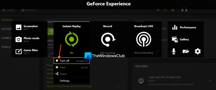

2] Turn off Instant Replay
As per some user reports, switching off the Instant Replay function in Nvidia Geforce Experience helped them fix the issue. So, you can try doing the same and see if the issue is resolved. Here are the steps to switch off Instant Replay:
- First, open the Geforce Experience app.
- Now, press the Alt+ Z hotkey to adjust overlay settings.
- Next, click on the Instant Replay option and turn it off.
- After that, exit the overlay settings and check if the problem is resolved.
