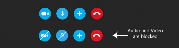

3] Check if the audio/video is muted in Skype
During a call, Skype allows users to mute or unmute the audio as well as video. In case you have turned them on and forgot to reverse the settings, you would not be able to get send/receive audio and video. Therefore, check whether the audio/video is unmuted or not. If the audio and video buttons have a slash, you should click on them to disable them. Check the image for a better understanding.
