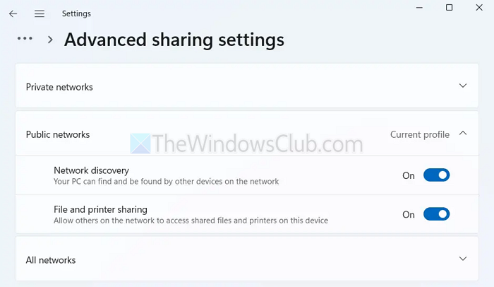

1] Enable Network discovery
After a recent Windows update, some users have reported the computer or other devices fail to appear in the network list. Because of that, they are unable to share files and printers between different PCs.
To double check if you run the “net view” on an elevated comment prompt, you should get System error 6118.
- Navigate to Network & internet > Advanced network settings > Advanced sharing settings.
- Over here, enable Network discovery and Turn on file and printer sharing.
To prevent further issues, make sure that all the devices on your network have Network discovery and file sharing. To cross-check, run the net view command again and confirm if the error does not appear anymore.

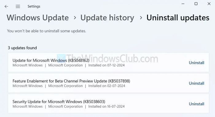

3] Uninstall recent updates
You can also go back to the previous version of Windows or roll back the new update. For this, follow these steps:
- Press Windows Key + I to open Settings.
- Navigate to Windows update > Update History > Uninstall updates.
- Select the recently installed updates individually, recheck your network sharing settings, and see if it fixes the issue.
Read: Latest Windows Updates not showing on my Windows 11 PC; Why?
Those were a few ways to fix network devices not showing after the Windows update. You should consider uninstalling recent Windows updates and only updating your Windows once a patch for the bug is available.
