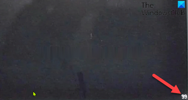

Some PC users using MSI motherboards are experiencing the issue whereby when they boot or reboot their Windows device, the error code 99 appears in the bottom-right corner of a black screen. In this post, we will identify the potential causes as well as provide the most suitable solutions to the issue.
What does 99 mean on a motherboard?
Error code 99 on a motherboard indicates hardware issues or a potential power surge affecting the system. It suggests a failure in the motherboard’s functionality. It’s recommended to contact the manufacturer, such as MSI, for further diagnostics to resolve the issue. This error commonly points to an underlying hardware problem.
