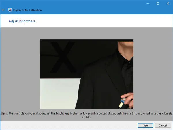

4] Display Color Calibration
Display Color Calibration is a simple yet very useful tool provided by Microsoft with Windows operating system. You can search for DCCW in the search box and follow the wizard to set up your monitors. You need to do the same with every single screen. It will let you check the proper brightness, contrast, etc. based on the monitor.
