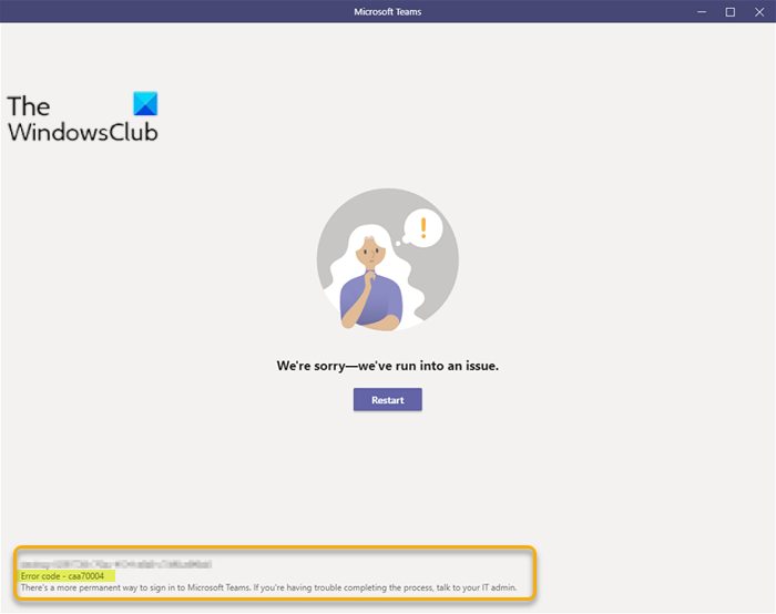

If when you try to start the Microsoft Teams desktop app on your Windows 11 or Windows 10 computer, but receive the Error code caa70004, then this post is intended to help you with the most adequate solutions to fix the issue. Microsoft Teams is a communication platform developed by Microsoft office; it allows your team to stay organized and have conversations. Although Microsoft Team is an excellent platform for discussion, customers can experience such errors.
When you encounter this issue, you will receive the following error message:
Error code – caa70004
There’s a more permanent way to sign in to Microsoft Teams. If you’re having trouble completing the process, talk to your IT admin.
Why am I getting an error code on Teams?
There could be a number of reasons PC users are getting error codes on Teams. It could be that you’re not using the right credentials. The Windows Credentials you signed in with are different than your Microsoft 365 credentials. In this case, to resolve the issue, try to sign in again with the correct email/password credentials. If you continue to receive this status code, contact your IT admin.
Microsoft Teams Error code caa70004

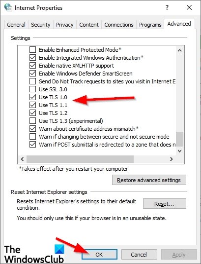

3] Enable TLS in Internet Options
This solution requires you to enable TLS in Internet Options on your Windows 11/10 device. To enable the TLS, follow the steps below.
Type Internet Options in the search bar and select it from the pop-up panel.
Once the Internet Properties interface is open, select the Advanced Settings tab.
Under the Security section, check to see if you have TLS 1.1 enabled and TLS 1.2 enabled; if not, check their checkboxes to enable them.
Select OK to save the changes.
Try to run Microsoft Teams to see if the issue persists.

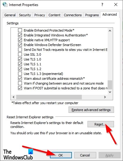

9] Reset the Internet options
You can fix the issue by resetting the Internet Options.
Sign out of your account and ensure that Microsoft Teams is not running in the background.
Then type Internet Options in the search bar and select it from the pop-up panel.
On the Internet Option interface, click the Advanced tab.
Then, scroll down and click the Reset button.
Close the window and try to launch Microsoft Teams.

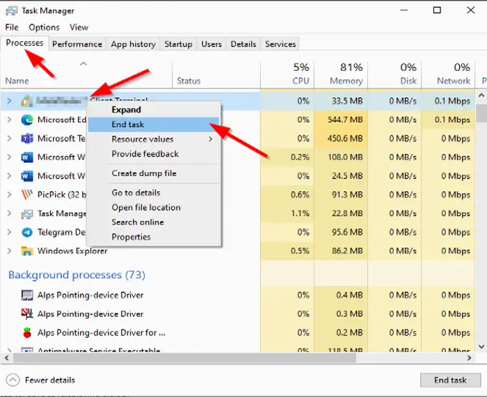

10] Close background programs
Apps or programs running in your background might trigger Microsoft Teams causing the error to occur, and the solution is to close the apps. To close the apps, follow the steps below.
Go to Task Manager.
Once the Task Manager interface opens, click the Processes tab.
Then right-click the program you want to close and click End Task from the context menu.
Try to launch Microsoft Teams to see if the error continues.

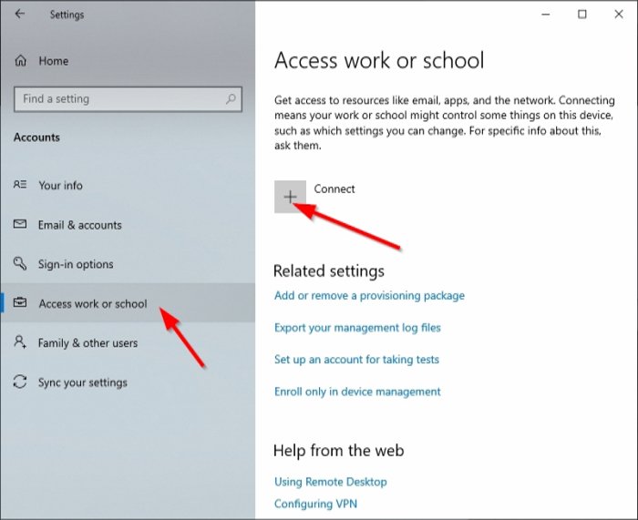

11] Add your office account to the user list
Click the Start button and click Settings.
On the Settings interface, click Accounts.
Then click Access Work or School on the left pane.
Click the + Connect button on the right, then log in using your office 365 credentials.
Try to open Microsoft Teams again.

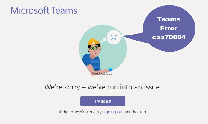

What is Microsoft Teams Error caa70004?
Microsoft Team error caa70004, We are sorry, we’ve run into an issue prevents you from logging into Teams and joining the discussion. Network issues usually cause it.
What are the causes for Microsoft Team error caa70004?
Some issues, such as network problems, caching issues, server issues, and sign-in problems, may cause Microsoft Teams error caa70004.
