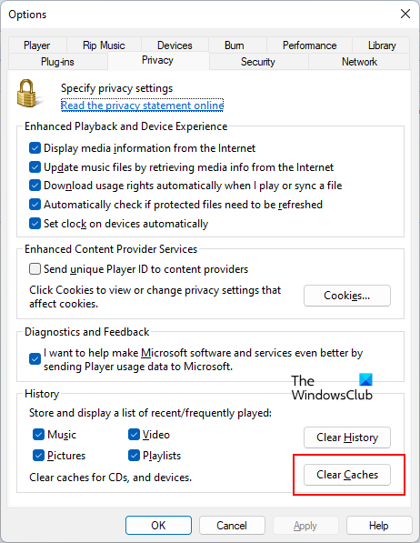

2] Clear Windows Media Player cache
The cache is a storage location that stores some amount of data of websites, web browsers, apps, etc., in order to serve the same data requests faster. The corruption in cache data causes several problems. You can fix this issue simply by clearing the cache data.
You might be experiencing the issue of media keys failure in Windows Media Player due to cache data corruption. The following instructions will help you clear the Windows Media Player cache data files:
- Open Windows Media Player.
- Go to “Tools > Options.”
- Select the Privacy tab.
- Click on the Clear Caches button.
Restart Windows Media Player and see if the issue persists.

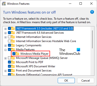

3] Disable and re-enable Windows Media Player via Windows Features
If none of the above solutions work, disable and re-enable Windows Media Player via Windows Features. It should work.
The entire process is described below:
- Open the Control Panel.
- Select Category in the View by mode.
- Click Programs.
- Click Turn Windows features on or off under the Programs and Features section.
- Now, expand Media Features and uncheck the Windows Media Player checkbox. Click Yes in the confirmation box.
- Click OK.
- Restart your computer.
- Repeat the first four steps again and expand Media Features. Select the Windows Media Player checkbox and click OK. This will enable the Windows Media Player again.
- Restart your computer again.
