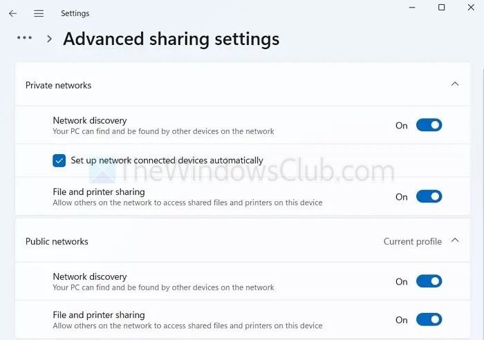

1] Ensure Network Discovery is enabled
If you have recently updated Windows, it might have overwritten the network permissions. So, ensure that Network discovery is enabled across your devices before proceeding.
- Press Windows Key + I to open Settings.
- Go to Network & Internet> Advanced network settings > Advanced sharing settings.
- Over here, toggle on Network Discovery and File and Printer Sharing.
- Once done, reboot your computer, try to access your network drives, and see if it works.

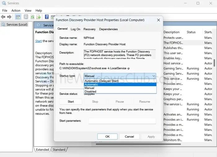

2] Ensure the Network Services are running for Mapped drives
Finally, to ensure that your mapped drives are working properly, you must enable certain Windows services. Here’s how:
- Press Windows Key + R to open Run.
- Type services.msc and press Enter.
Locate the following services and right-click on them one by one:- Function Discovery Provider Host
- Function Discovery Resource Publication
- SSDP Discovery
- UPnP Device Host
- For each service, you need to select Properties.
- If the service is not running, click on Start.
- Also, set the Startup type to Automatic.
- Finally, click on Apply > Ok.
After enabling these services, reboot your computer and then try to access your network drives and see if you find any issues.
