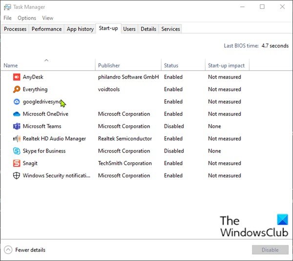

1] Check startup items in Task Manager
Windows 10 provides a tab/column in the Task Manager to view all startup items.
To check startup items in Task Manager in Windows 11/10, do the following:
- Press Ctrl + Shift + Esc keys to open Task Manager. Alternatively, right-click on an empty portion of the Taskbar at the bottom of your screen and choose Task Manager. If Task Manager opens in compact mode, click or tap on More details.
- Switch to the Startup tab.
Here, you can see all the programs on your computer that run as soon as you log in – with the headers for the app name, Publisher, Status, and the Startup impact of each item. If you right-click on one of these headers, you can show additional information – the Running now on the context menu is particularly useful, as it lets you know whether an app is actually in use.
Apart from the basic startup items or the ones you added yourself, identify any unusual app.
- To prevent an app from running at startup, select it and click the Disable button at the bottom-right.
- Exit Task Manager.
- Restart your computer.
See if the Invalid command line error prompt pops up again. If it does, try the next solution.

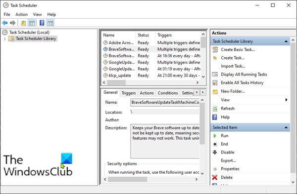

2] Check Scheduled Tasks in Task Scheduler
The Windows Task Scheduler is like an alarm clock that you can set, to start a procedure under specified circumstances.
To check scheduled tasks in Task Scheduler in Windows 11/10, do the following:
- In the Run dialog, type
taskschd.msc. - Press CTRL+SHIFT+ENTER key combo to open Task Scheduler in admin mode.
- On the left pane, click Task Scheduler Library
- In the middle pane, you can see a list of your Scheduled Tasks. In the lower pane, you can select any single task to see its Properties. The Actions tab shows which file will be run when the Scheduled Task is triggered.
- If you have found a task that you wish to remove, you can select the task and click Delete under Actions > Selected Item, on the right pane.
- Click Yes on the prompt to confirm the deletion.
- Exit Task Scheduler.
See if the issue is resolved. Otherwise, try the next solution.
