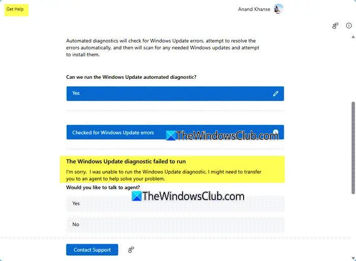

The Windows Update troubleshooter is meant to resolve issues related to Windows Update. However, we have noticed that it starts throwing an error that says that the Windows Update diagnostic failed to run. This issue appears in the Get Help app, which is the latest iteration of troubleshooters introduced by Microsoft. In this post, we are going to see what you can do if the Get Help Windows troubleshooter says I am unable to run the Windows Update diagnostic.
Checked for Windows Update errors
The Windows Update diagnostic failed to run
I’m sorry. I was unable to run the Windows Update diagnostic. I might need to transfer you to an agent to help solve your problem.

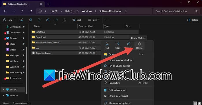

1] Clear Software Distribution and Catroot2 folders
When you run the Windows Update troubleshooter, it tries to check all the update components which includes the Software Distribution and Catroot2 folders. These folders are notorious for getting corrupted pretty easily and causing issues. So, in this solution, we will clean the update cache, stop the services related to Windows Update, delete files in C:\Windows\SoftwareDistribution, and restart all the services. For that, launch Windows Terminal as Administrator. Then, run the following commands to stop the services:
net stop wuauserv net stop cryptSvc net stop bits net stop msiserver
Open File Explorer and navigate to C:\Windows\SoftwareDistribution. You then have to delete all files and folders in the SoftwareDistribution folder. Alternatively, rename the folders to SoftwareDistribution.old or something else.
Now, we are going to deal with the Catroot2 folder, for that, open the Terminal and run the following commands.
md %systemroot%\system32\catroot2.old
xcopy %systemroot%\system32\catroot2 %systemroot%\system32\catroot2.old /s
You then have to delete all the content of the Catroot2 folder. Once done, run the following commands to start the service we asked you to stop earlier.
net start wuauserv net start cryptSvc net start bits net start msiserver
Once done, go ahead and run the Get Help troubleshooter. If the Windows Update error is because of the corrupted Software Distribution and Catroot2 folders, your issue will be resolved.

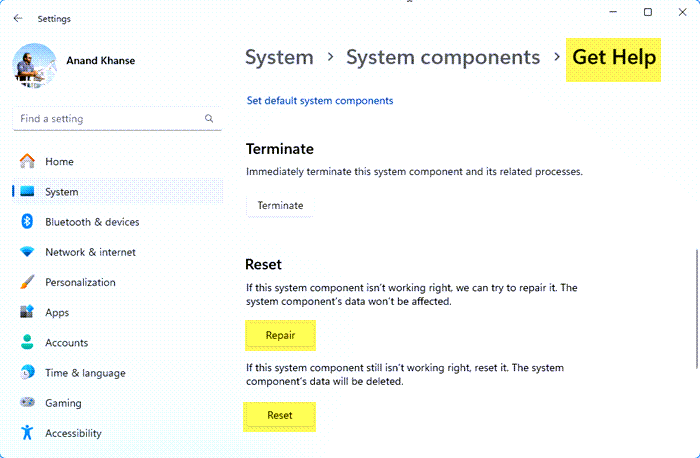

3] Reset Get Help app
Reset the Get Help app from Windows Settings and then try and see if it helps.

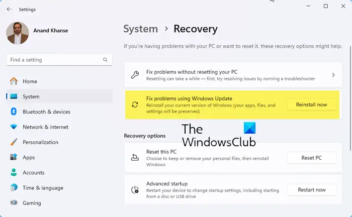

5] Reinstall Windows using Windows Update
If your issue persists after clearing out the Software Distribution and the Catroot2 folders, you should consider reinstalling your operating system using Windows Update.
- Open Settings by Win + I.
- Now, go to System > Recovery.
- Go to Fix problems using Windows Update section and then click on the Reinstall now button.
- A blue window will appear. You may select the Automatically restart my PC 15 minutes after installation check box and click on OK
- Your PC will start and the repair process will initiate.
You need to follow the on-screen instructions to complete the reinstallation process. Once done, go to Windows Settings > Windows Update, and then check if you are able to install the update. If not, run the troubleshooter again.
