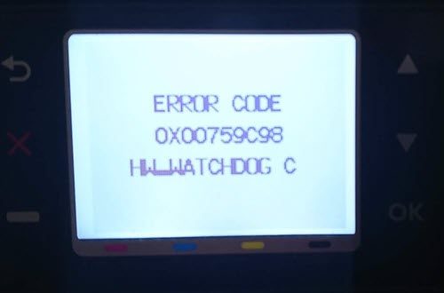

In this article, we will show you how to fix the HP Printer Error Code 0X00759C98 HW WATCHDOG C. This error usually appears due to some hardware issues. For example, the problem may be with your ink cartridge, motor, etc. In addition to this, this error code can also occur due to the bad printer driver.
Fix HP Printer Error Code 0x00759c98
If you get HP Printer Error Code 0X00759C98 HW WATCHDOG C, use these fixes to resolve this issue.

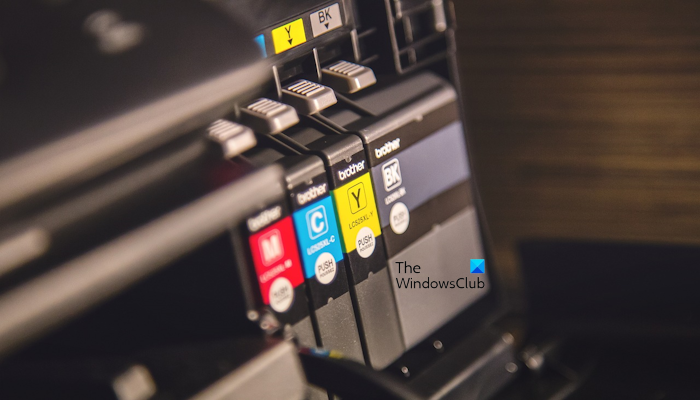

1] Check your ink cartridge (it may be jammed)
The first step you should do is check if your ink cartridge is jammed or not. Dust, dirt, and ink can accumulate in the printer, causing various problems, such as paper jam, ink cartridge jam, etc. Disconnect your printer and then turn it off. Now, open the printer cover and check if the ink cartridge is jammed or not. If the ink cartridge is stuck, fix it.
You should also try reseating the ink cartridge. Remove the ink cartridge, clean the printer, and then put it back in its place. No, check if the problem persists.
