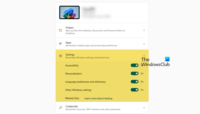

- Click on Settings, and then toggle on or off the options given there. Alternatively, go to Settings > Account > Windows Backup and then configure Remember my preferences.

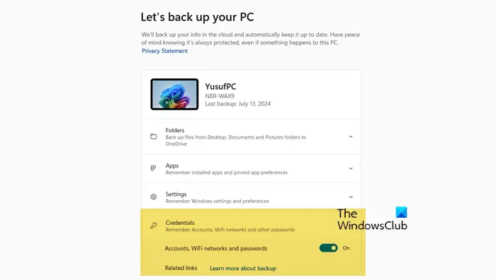

- Finally, let us go to Credentials. There, you need to toggle on or off Wi-Fi networks & passwords.

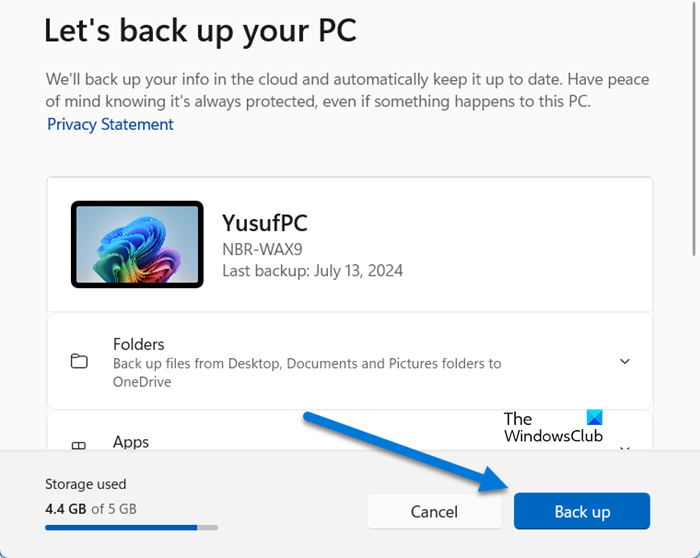

After configuring everything, click on the Back Up option. This will start backing up the data you have specified.

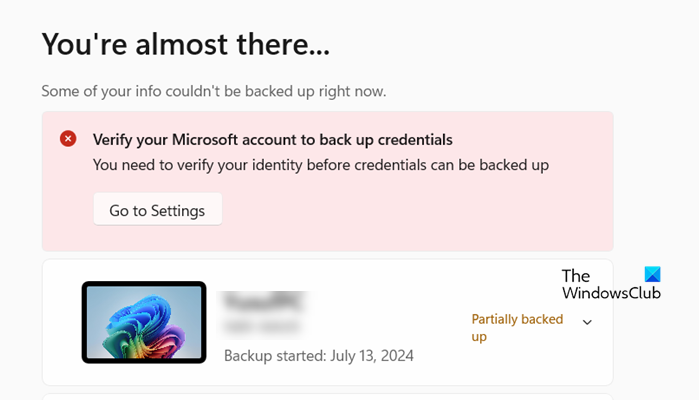

You may see an option that says Verify your Microsoft account to back up credentials, click on Go to Settings. This will open the Settings page asking you to verify your account, click on Verify, and then follow the on-screen instructions to complete the process. Once your account is verified, you should be good to go back your WiFi credentials as well.

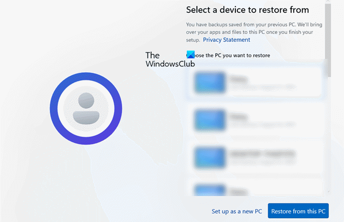

- After selecting the Region, Language, and Keyboard, we will be asked to enter a name.
- Upon specifying a name, you need to click on Next and select Set up for personal use as we are going to restore the backup from your personal account.
- Click on Sign in and enter your account credentials to log in.
- From the Restore from your PC backup section, click on the Restore from this PC option.
- Finally, follow the on-screen instructions to complete the process.

If you want Windows 11 to remember your app preferences, you can use the Windows Backup app. Open the app, go to Settings, and then toggle on or off the options for Accessibility, Language preferences, Other Windows settings, and Personalization. Once configured, click on Back Up. You can also go to the Apps tab and configure the option there.
Alternatively, go to Settings > Account > Windows Backup and configure Manage sync settings.
