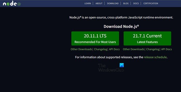

2] Set up NodeJS
It’s important to note that while you can use VSCode to edit Angular, you cannot run it directly within the editor. Angular is actually executed within NodeJS, which is a JavaScript environment that’s part of your local web development setup. With NodeJS, you can run Angular on your local host in a web browser. Every time you make changes to your Angular code in VSCode, it will automatically reload in the browser, which is known as “hot reload”. However, since Angular runs in NodeJS, you’ll need to install NodeJS first. You can do this by going to nodejs.org.
When installing Node JS to run Angular, choose a location that is easy to remember, like a simple and short path. This will be helpful if you need to use NodeJS later. So, instead of installing the app in Program files, install it in D:\NodeJS, albeit it doesn’t matter.

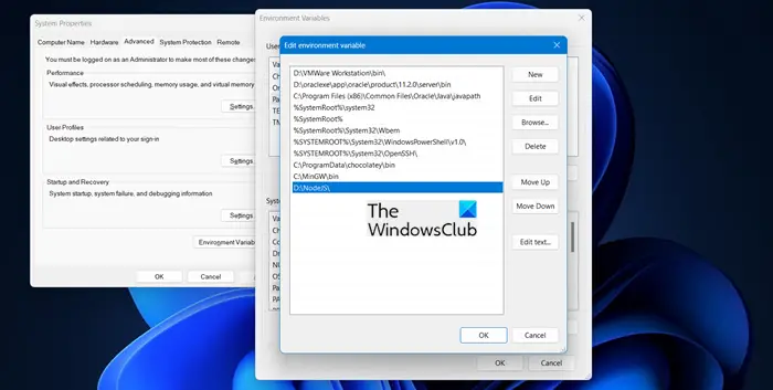

3] Set up the environment variable
Next up, we need to set up the environment variable for NodeJs before we go ahead and install Angular. To do the same, follow these steps.
- Hit Win + S, type “Environment Variable” and then open it.
- Once done, you need to copy the location of NodeJS. Just for reference, ours is D:\NodeJS.
- Click on Environment Variable.
- Now, select Path in the System Variable section and click Edit.
- Click on New, paste the location, and click on Ok.
This way, you have entered the NodeJS Environment variable. To check if it’s working, open Command Prompt and then run node –version. If it gives you a version, we are good to install Angular.
