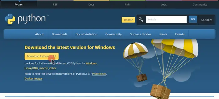

Our first job should be to download and install Python on our computer. Unlike C or C++, installing Python is pretty simple, all you have to do is go to python.org and click on the Download button. This will start downloading the Python installer. Once done, run the installer and follow the on-screen instructions to complete the installation process.

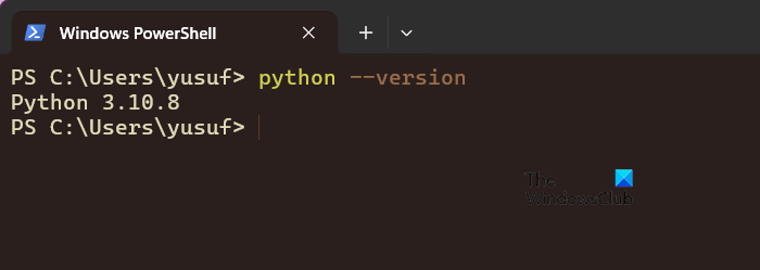

To confirm if Python is installed or not, we will check its version. To do the same, open Terminal, Command Prompt, or PowerShell and run the following command.
python --version
If you get a Python version as an output, you have successfully installed Python on your computer. In case, Python is not installed, go ahead and re-run the installation media we asked you to download earlier.

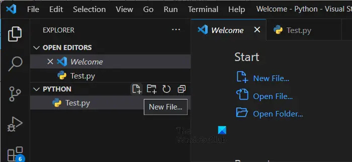

Once you have installed Python and VS Code IDE, all you need to do is create a Python file. To do that, open Visual Studio Code, go to File > New File, search for Python file, and click on it. This will generate a Python file. However, we would not recommend you go with this method, instead, create or select a folder first, then open that folder in VS Code, click on the New File button, and give it any name with a .py extension.

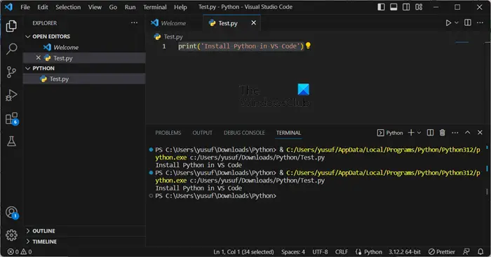

After creating and opening the Python file, write a code and click on the Run button. This will execute the code and give you an output screen. If there is an error in your code, you will be notified.

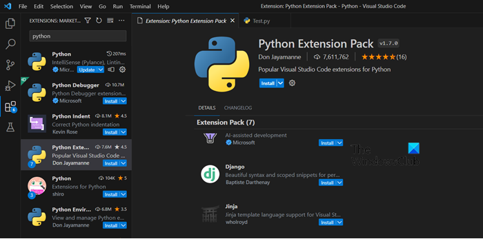

5] Install the Python Extension Pack
Even though this step is optional, we recommend you download the Python Extension Pack. It is a must-have for someone who is serious about programming as apart from Python it includes the following things.
- Jinja template language support for Visual Studio Code.
- Beautiful syntax and scoped snippets for perfectionists with deadlines in Django.
- Visual Studio IntelliCode provides AI-assisted productivity features for Python developers in Visual Studio Code. It offers insights based on understanding your code combined with machine learning.
- Python Environment Manager lets you view and manage all of your Python environments and packages from a single place.
- Python Docstring Generator helps you quickly insert Python comment blocks with contextually inferred parameters for classes and methods based on multiple, selectable template patterns.
- Python Indent corrects Python indentation in Visual Studio Code.
- Jupyter provides Jupyter Notebook support for Python language. It’s used for data science, scientific computing, and machine learning.
To install it, go to Extensions, search for “Python Extension Package” and click on the Install button.
