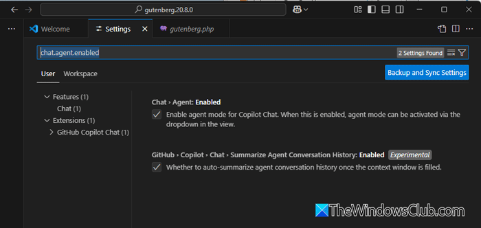

To enable the agent mode in Visual Studio Code, you need to open the program first. Then, go to File > Preferences > Settings.
Next, search for this:
chat.agent.enabled
Make sure that the Enable agent mode for Copilot Chat checkbox is ticked.
You can also tick the following checkbox, called Whether to auto-summarize agent conversation history once the context window is filled.
Once done, you can find a panel on the right-hand side. From here, you need to set the agent. For that, click on the Agent option and sign in to your Copilot account by clicking the Sign in option.

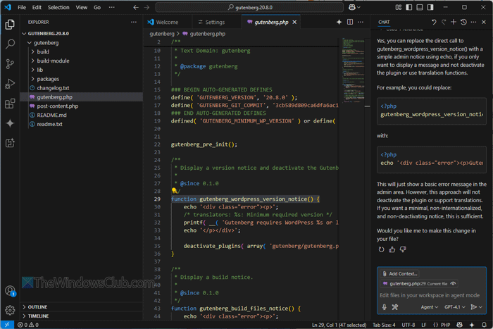

To run the VS Code AI Mode, you need to open a code file. It could be anything, including PHP, JS, Java, C#, or anything else. Then, select a piece of line of code and press Ctrl+Alt+I. It opens a panel on the right-hand side.
You can use this panel to chat with the AI. It is possible to do these:
- Code explanation: You can explain and comprehend any line of code. For that, just select the code or function, and type “explain this function/line”.
- Find error: If you do not want to find errors in your code manually, you can simply ask the AI to get the job done for you.
- Create new file: You can create a new file of code from scratch. All you need to do is enter the exact thing you want from the AI. For example, if you want to design a webpage, you can ask it to create a CSS file with the color name of the header, title color/font, etc.
- Run the code for you: You can run your code automatically and compile it on the go.
- Replace function: If you want to replace or tweak a function, you can ask the AI. It can display two or three options as per the requirements. You can opt for one of them that fulfills your needs.
In simple words, you need to give the command to the AI and let it be executed.
