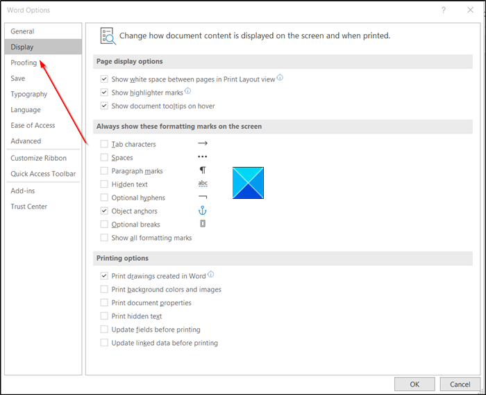

Click the tab and in the sidebar displayed on the left, scroll down to Options.
Click the Options to open the Word Options window.
Next, switch to the Display tab.
Switch to the right-pane and scroll down to Printing Options.
There, check the box marked against the ‘Print background and color images’ option.
