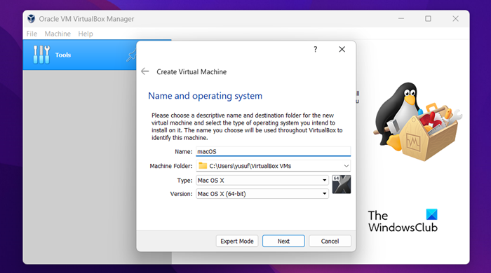

3] Create the Virtual Machine
In order to install macOS, we first need to create a virtual machine using Oracle VirtualBox. The process may seem a bit intimidating, but if you follow the steps mentioned below, you will be able to create a VM without any hassle. To do the same, just follow the prescribed steps.
- Launch Oracle VirtualBox on your Windows system.
- Click on the New button.
- In the next window, you need to enter the following details.
> Name: You can enter any name you want to give to this virtual machine, but just to have a rememberable name, use a simple name such as macOS or MacintoshMachine.
> Machine Folder: This is the location where your VM will be stored, make sure to select a disk with at least 100GB of free space.
> Type: Select Mac OS X (will be selected automatically)
> Version: Select Mac OS X (64-bit) (will be selected automatically) - On the next window, use the slider to allocate RAM to your VM, give it enough memory but should not be more than 50% of total capacity.

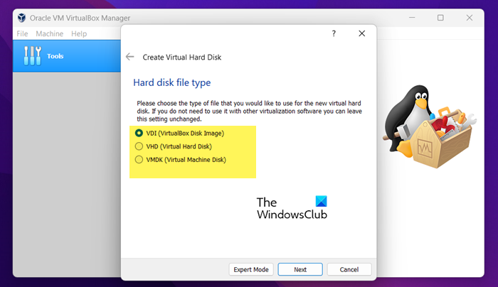

- On the Hard disk window, select Create a virtual hard disk now and click Create.
- You then have to select the Hard disk file type, we have mentioned their description below, so, select the one you think is apt and then move on.
> VDI (VirtualBox Disk Image): Not for someone who might need to shift their Virtual Machine to some other VM Software such as VMWare Workstation or Hyper-V.
> VHD (Virtual Hard Disk): Apt for transferring the VM to Hyper-V.
> VMDK (Virtual Machine Disk): Best for someone who wants to migrate their VM to VMWare. - Next up, you can select Dynamically allocated if you are not sure how much space is good and Fixed Size if you are certain of the space the VM should be allocated. We recommend you go for dynamic allocation especially if you are using SSD.
