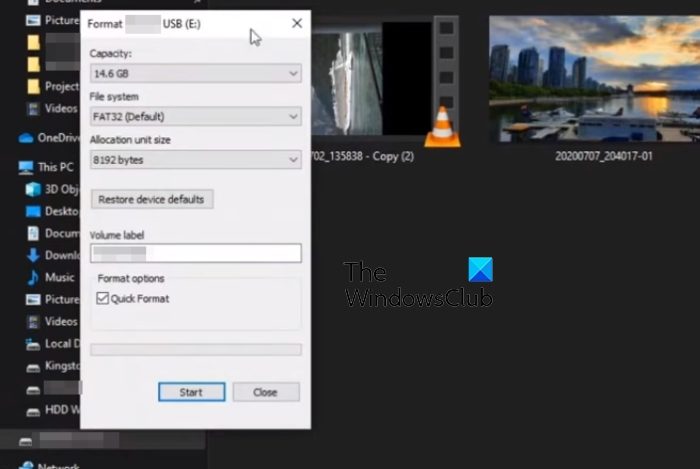

2] Format the USB stick
OK, so to fix this problem with a USB stick, you must ensure the stick has at least 8GB of storage space.
Furthermore, it should be formatted in FAT32 over all other options.
- Go to This PC, then right-click on the USB stick icon.
- Select the Format option from the context menu.
- Before formatting, ensure FAT32 is selected, then move forward.
