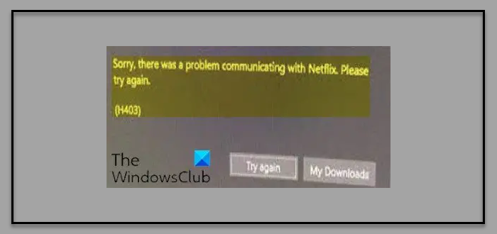

When the Netflix app fails to launch or stream content, you’ll receive the following error message and code, as the case may be;
Sorry, there was a problem communicating with Netflix. Please try again.
(H403)
Netflix error code H403 typically indicates an issue with the temporary information stored on your computer. If you’re encountering error code H404, it’s most likely due to the fact that your UWP application is outdated.
Fix Netflix error code H403 and H404
