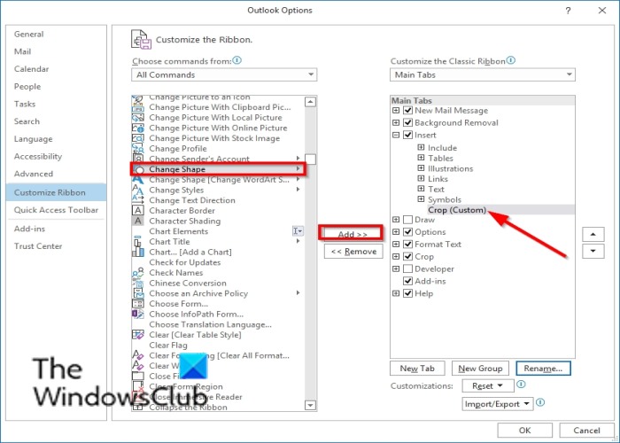

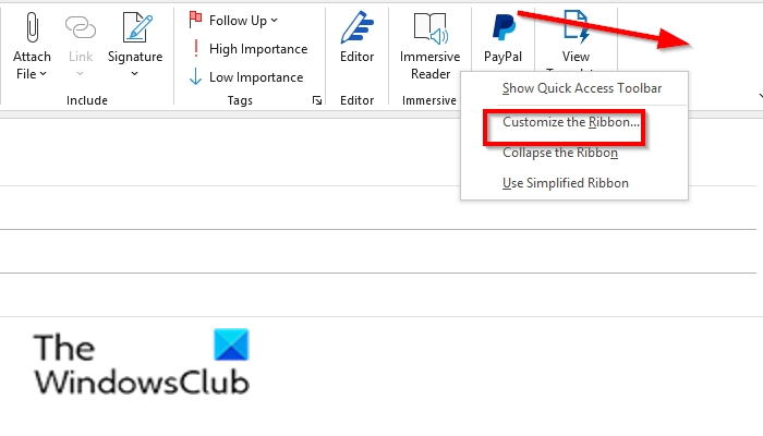

- Right-click the ribbon and select Customized Ribbon.
- An Outlook Options dialog box will open.
- Now on the Customize Ribbon tab, click the tab that you want the Crop to Shape button to be, then click the New Group button.
- The New Group ( Custom) will appear under the selected tab.
- Rename the group by clicking the Rename button.
- A Rename dialog box will open. Rename the Group.
- On the right click, the list box of Choose Commands from and select All Commands.
- Then scroll down and select the Crop to Shape button.
- Then click the Add button.
The Crop to Shape feature will go under the new group, then click OK.

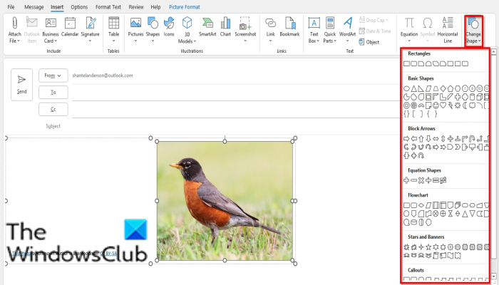

Click the Insert tab and click the Picture button; you can choose the picture from File, Stock Images, and Online Picture.
Now go to the tab where you choose to place the Crop to Shape button. In this tutorial, we place the Crop to Shape under the Insert tab.

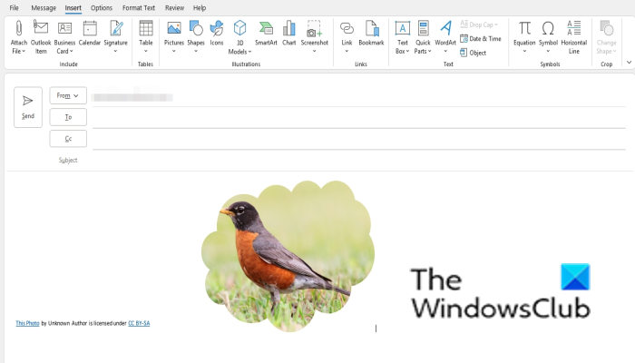

Click the Crop to Shape button, then select a shape from the menu.
Any shape you have chosen, the picture will turn to that shape.
