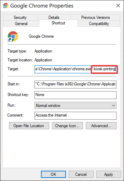

Start by closing all instances of Google Chrome. With Chrome closed, find its shortcut and right-click on it. Choose the Properties option from the context menu. Navigate to the Shortcut tab in Properties.
Add the following command-line switch to the end of the Target field:
-kiosk-printing
Hit the Apply button and click on OK to complete the operation.
After adding this switch to the Target field, whenever you want to print out a webpage off Chrome, the print dialog box shows up briefly and then closes immediately.

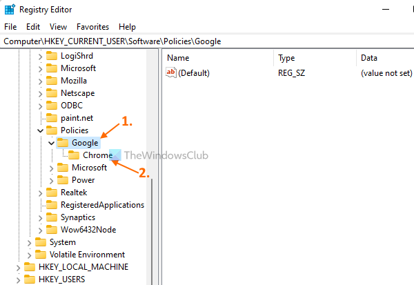

After opening the Registry Editor, access a Google name Registry key. Here is the path to access it:
HKEY_CURRENT_USER\Software\Policies\Google

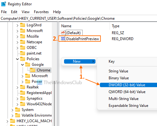

If for some reason, this Google key is not present, then first create a new Registry key, and name it Google. Under the Google key, create a new key, and name it Chrome (as visible in the image added above).
Now, on the right section of the Chrome Registry key, open the right-click menu, go to the New section, and click on DWORD (32-bit) Value. After this, rename that DWORD value to DisablePrintPreview.

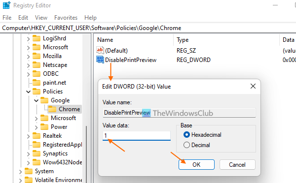

It is time to set the Value data of this DWORD value so that you can disable the print preview feature of Google Chrome. For doing this, double-click on the DisablePrintPreview DWORD value. You will see an Edit DWORD (32-bit) Value box. There, add 1 in the text field of Value data, and press the OK button.
Finally, restart the Chrome browser if you have opened it. Now whenever you will try to take a print of a webpage, the system print dialog will open.

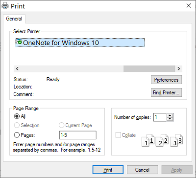

Print using system dialog helps to take print of a webpage using the system print dialog box for browsers like Chrome, Firefox, and Microsoft Edge. Using that box, you can select a printer, set page range, number of copies, page layout, etc., before you print a page.
By default, when you try to take a print of a webpage, the print preview feature of the web browser is opened. But, if you want, you can also use the system print dialog to take print of a webpage in Chrome, Firefox, and Edge browsers. For this:
- Open the print preview dialog box of a browser
- Access the More settings section
- There, you will see a Print using system dialog option. Click that option and the system print dialog will open.
How to print using System Dialog in Chrome?
To print using the System Dialog in Chrome, press Ctrl+Shift+P, or click the three-dot menu > Print, and then in the print window click More settings > Print using system dialog. This opens Windows’ native print dialog, where you can select printers, adjust preferences, and confirm printing.
