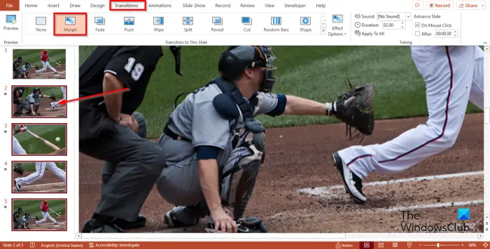

Follow the steps below on how to use the Morph animation to zoom into specific parts of your PowerPoint slide:
- Launch PowerPoint.
- Change the slide to blank.

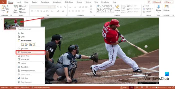

- Insert a picture into the slide.
- Right-click the slide and select Duplicate.

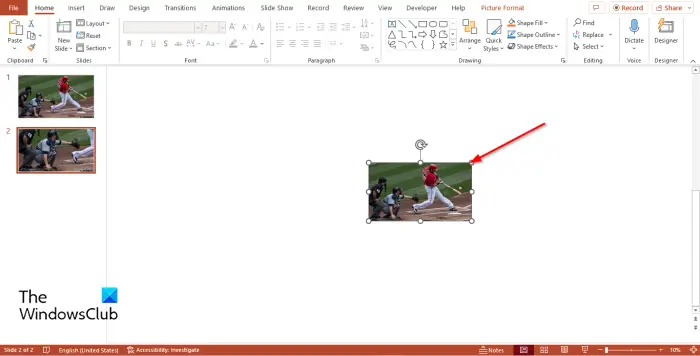

- Zoom out the second slide picture.
- Then try to enlarge the image by dragging the points on the slide.
- Right-click the second slide and select Duplicate. Do the same for the third slide.
- Now duplicate the original slide, then place it at the end.
- Click the first slide, then press the shift key to select the others below.
- Now zoom the slide to 80%.
- Click the second slide, then press and hold the Shift key to select the others below.
- Click the Transition tab and select Morph.

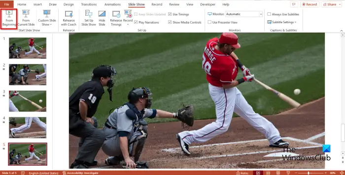

- Click the Slide Show tab, then click the From Beginning button.
- Click on the slide to play the transition.
- Press the Esc button to Exit the slide show.
Launch PowerPoint.
Change the slide layout to blank.
Insert a Picture.
Now we are going to duplicate the slide.
Right-click the slide and select Duplicate from the context menu.
The picture on the slide will be duplicated.

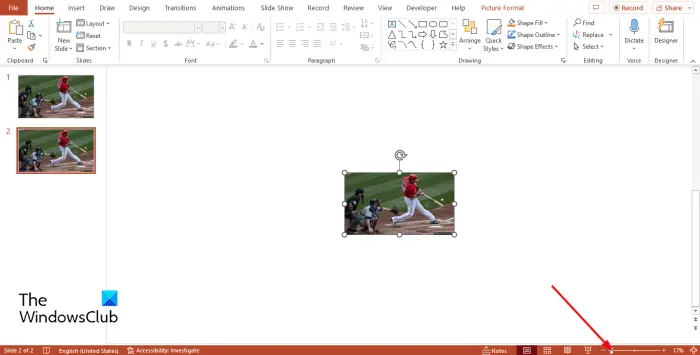

Now Zoom out the second slide picture by pressing the Ctrl button and scrolling down the mouse button or clicking the Zoom out button on the Zoom bar on the bottom right of the PowerPoint interface.
Then try to enlarge the image by dragging the points on the slide. You will notice a square on the picture while you are dragging it. This square represents where the picture will be zoomed in.
Now right-click the second slide and select Duplicate.
Follow the same procedure as the previous one.
Now right-click the third slide and select Duplicate.
Now duplicate the original slide, then place it at the end by dragging the slide to the end.
Click the first slide, then press the shift key to select the others below; now zoom the slide to 80%.
Then click the Transition tab and select Morph from the gallery.
It will appear on the slide show window.
To play the transition, click on the slide.
