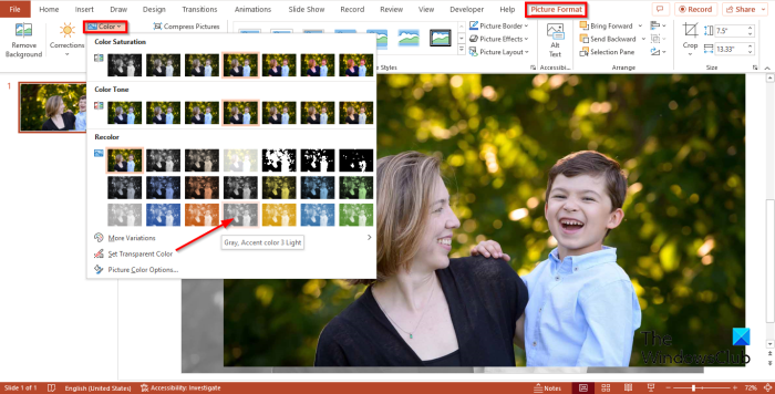

Now we want to turn the previous picture grey.
Click the previous picture, then go to the Picture Format tab.
Click the Color button in the Adjust group.
In the Recolor section, you can choose any color you want. In this tutorial, we choose the Gray, Accent color 3 Light.
The previous picture will turn grey.

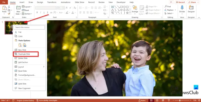

Right-click the slide and select Duplicate Slide from the context menu.

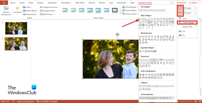

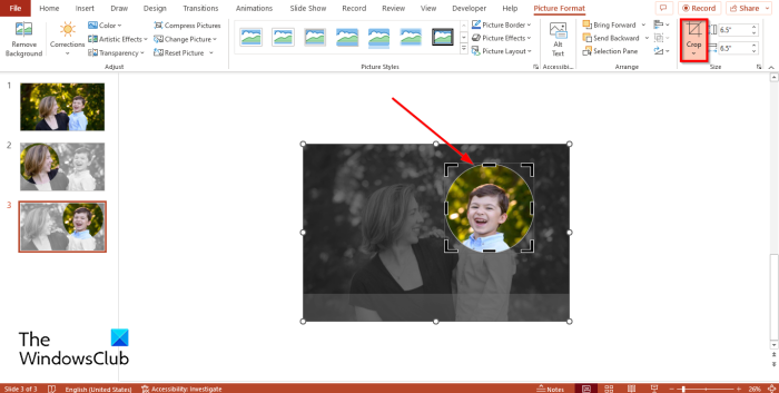

Now we are going to use the Crop feature.
Click the Picture Format tab.
Click the Crop button and select Crop to Shape from its menu. You can select any shape you desire; in this article, we choose the oval shape.
Now draw the shape over the picture.

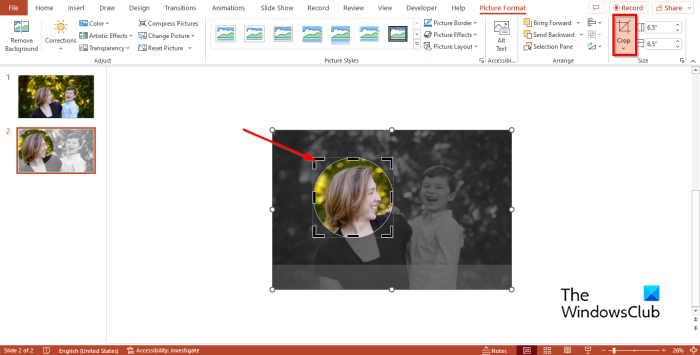

Click the Crop button and decrease the picture to spotlight a particular section in the photo.
Now, right-click and duplicate the second slide.
Click the crop area on the photo, then click the Picture Format tab and click the Crop button.
Now place the cursor over the edge of the cropped photo until you see a double arrow and drag it to the area you want it.

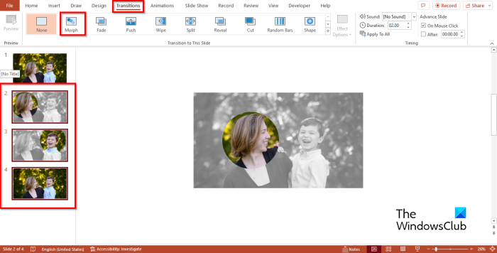

Now duplicate the original slide and place it at the end.
Press and hold the Shift key to select the last three slides, then go to the Transition tab and select Morph from the gallery.

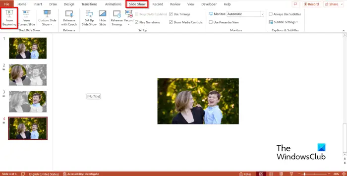

Now go to the Slide Show tab and click the From Beginning button; this will open the slide show window displaying the transition.
Keep on clicking on the slide show to make it work.
Press the ESC button to escape the slide show.
