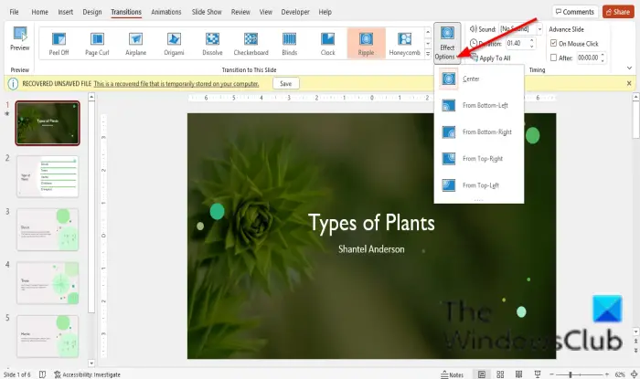

Click the slide you want to apply the transition.
On the Transition tab, in the Transition gallery, click the effect you want for the slide.
Click the Preview button in the Preview group to see a showing of the transition.
Click the Effects Options button to change how the transition occurs.

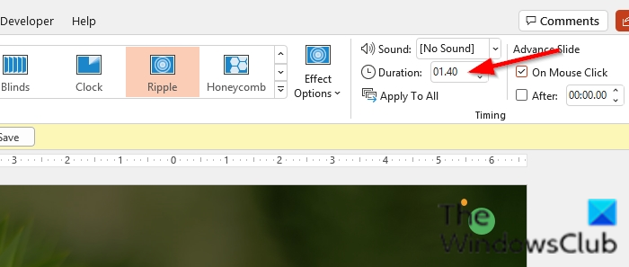

You can also enter a duration to set how fast the transition effect goes in the Duration entry box in the Timing group.
