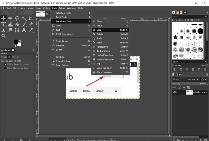

1] How to crop an image using GIMP
Folks have a million and one reasons for needing to crop an image. Luckily, this is possible using GIMP, so let’s take a look at what needs to be done.
Once you’ve added the photo to the work area, please click on the Crop tool via the tools palette or take the alternate route by navigating to Tools > Transform Tools > Crop.
After you’ve done that, the mouse cursor will change, indicating the Crop feature is activated.
Now, to crop the image, press the left-click then drag the mouse in the right area to adjust the image.

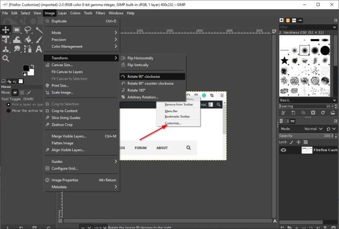

2] How to rotate or flip a photo with GIMP
Cropping is just one aspect of image manipulation in GIMP. One of the others is rotation or flipping.
Say, for example, you took a photo with a smartphone, but it is upside down or in the wrong orientation. With this tool, you can set the angle to the correct one, and it is not hard to accomplish either.
OK, so when it comes down to rotating or flipping, please add your image to the workspace, then click on Image > Transform. From here, you can select from any of the options available to rotate and or flip your photo.

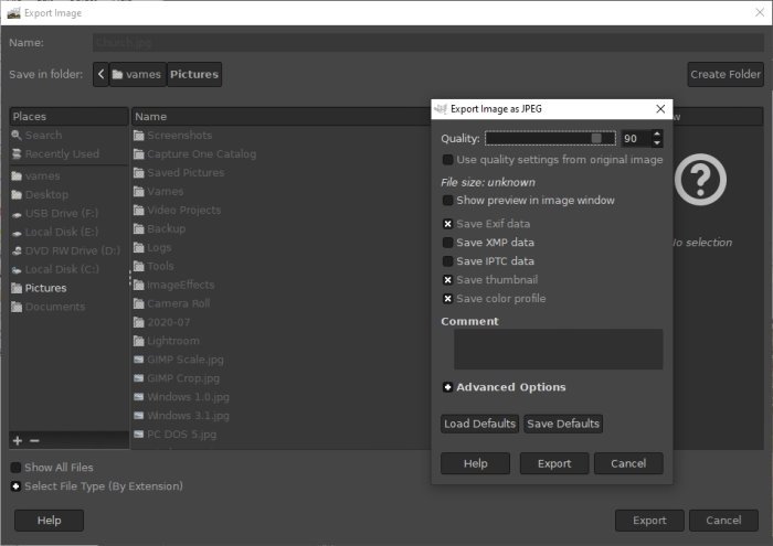

4] Change the file size of a JPEG photo in GIMP
Scaling an image is one thing, but can the file size be reduced? Well, yes, it is possible, and we will discuss how to do it right now.
To make a photo smaller, you must first make sure it is in the JPEG file format. Once that is confirmed, select File > Export, then add the name of the file. After doing that, click the Export button at the bottom of the box.
You should now see a small dialog box with the options to increase or reduce the image quality. If the picture has never been compressed before, then the quality will be at 100. If that is the case, drag the button down to reduce the size, and up to increase.
Bear in mind that if the size is reduced, then it means the picture is compressed and will lose quality.
