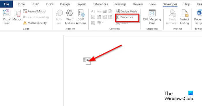

Launch Microsoft Word.
On the Developer tab, click the check box button in the Controls group.
Draw the check box on the Word document.
Now we will change the tick in the check box to an X.

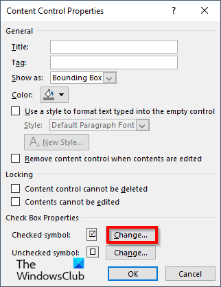

Click the check box, then click the Properties button in the Controls group or right-click the check box and select Properties from the menu.
A Content Control Properties dialog box will open.

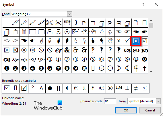

Under Check Box Properties, beside Checked Symbol, click the Change button.
A Symbol dialog box will open search for the X symbol, then click OK for both dialog boxes. If you want to find the x used in this tutorial, select Wingdings2 from the Font list box.

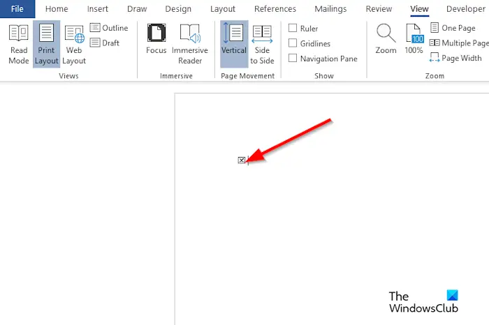

The tick in the check box is changed to an X symbol.
