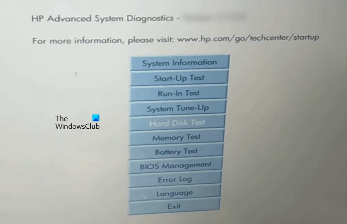

5] Run the Hard Disk Drive Self Test (if applicable)
Some HP laptops come with a hard disk test utility. Users can run this utility to test their hard drive. This option is available under the System Diagnostics section in HP computers. Turn on your HP laptop and keep pressing the Esc key. Now, press the required Function key to enter the System Diagnostics. These steps can be different for different HP laptop models. Therefore, it is better to refer to the official website of HP for more information.
Other laptop brands may or may not have this utility. You can check this on the official website of your laptop manufacturer or by contacting their support.
