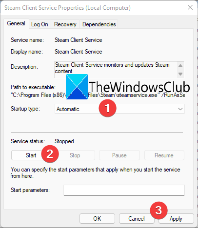

4] Restart Steam Client Service
If the above fixes didn’t work for you, you can try restarting the Steam Client Service. This method has reportedly been effective for some affected users and may also work for you. You can follow the instructions below to restart the Steam Client Service:
- Firstly, open the Services app by manually searching for it in the taskbar search. Or, open the Run dialog box using Win+R hotkey and enter services.msc in it.
- In the Services window, scroll down and locate the service named Steam Client Service, and then right-click on it and select the Stop option to stop it.
- Again, right-click on the Steam Client Service and select the Properties option.
- After that, select the service Startup Type as Automatic and then press the Start button.
- Next, press the Apply > OK button to save changes.
- Finally, relaunch the Steam and start GTA V and check if the error is fixed.
