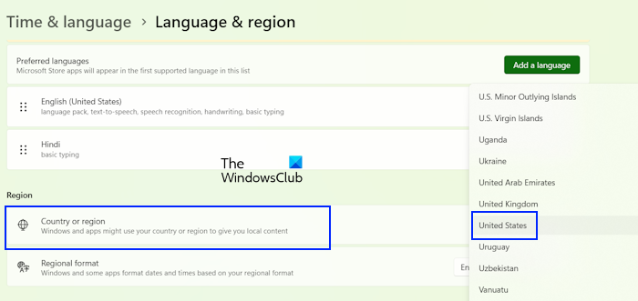

10] Try changing your Region to the United States
This also works sometimes. Once you are back to regular mode, change your settings to the US and try the update. This will work in case the update is stuck because of some delay from your local server.
You need to open Windows 11 Settings and go to Time & language > Language & region. Now, change your Country or region to the United States.
