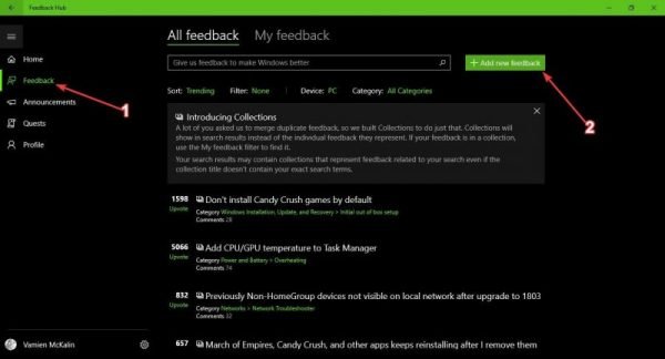

If your device is acting up but you have no idea what’s going on, then we suggest locating the error code and then making a formal report to Microsoft in hopes of getting some well-needed help. It’s an easy task, so let’s get down to it, shall we?
Press the Windows Key + X, then select Device Manager from the list. In the Device Manager, seek out the USB-C device, which should be marked by a yellow exclamation. The next step, then, is to right-click on this device and choose Properties.
You should see the error code under Device Status, so we suggest writing it down before taking the next step.
OK, click on the Start button and search for the Feedback Hub app. Launch it, then simply launch a complaint with the copied error code. A member of the Microsoft team should help in due time, so just wait patiently.
