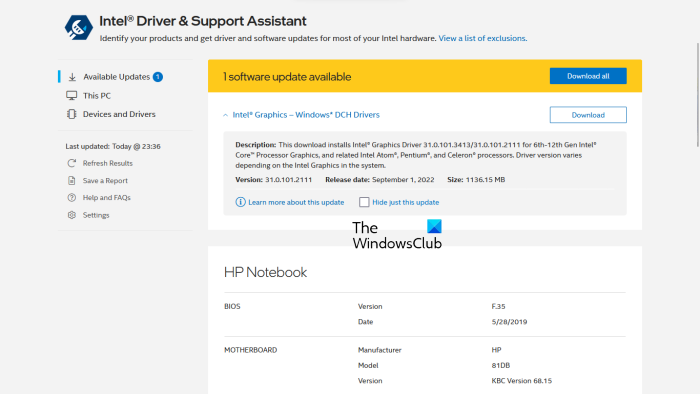

1] Update the graphics driver
As mentioned earlier, one of the main reasons behind the black screen glitch is the outdated graphics driver. So updating it should be the first step to fixing the issue.
Download the driver from the OEM’s website to update your Graphics driver. For instance, if you use a Laptop or a PC, you can head over to the manufacturer’s website and download the suitable driver based on your device model number. Also, for custom PC owners, you must visit your PC’s motherboard’s OEM website to download the supported graphics driver.

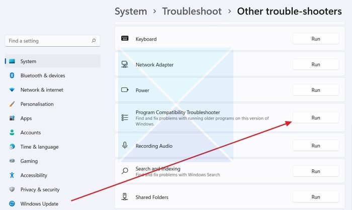

2] Run the Windows Compatibility Troubleshooter
If the above fixes didn’t help you fix the error, you could try running Windows troubleshooter. The Windows troubleshooter can be a great help to fix the issue on its own. If not so, it can at least offer you some hint of what the error could be. So you can find a fix further.
To run Windows troubleshooter, follow these steps:
- Press Windows Key + I to launch Settings.
- Go to System > Troubleshoot > Other troubleshooters.
- Click on the Run button next to Program Compatibility Troubleshooter.
- Next, let Windows detect the problem, asking you to select the culprit program. E.g., Microsoft Office Word.
- Finally, follow the on-screen instructions and see if it solves the problem.

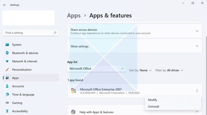

6] Repair, Reset or Reinstall Office Program
To ensure that there are no corrupted or missing files causing the Microsoft Office Black Screen glitch, you can try repairing Office Suite. Alternatively, you can also reinstall the office program to ensure the same.
To run Office repair, follow these steps:
- Press Windows + I to launch Settings.
- Go to Apps > Apps & features.
- Over here, search for Microsoft Office and click on the three dots icon next to it.
- Select Advanced Options, and then scroll to find the Repair and Reset option
- Finally, select Repair/Reset and click on the Next button.
Once the software is repaired, run any Microsoft Office programs and see if you are experiencing any glitches. If you are still getting glitches, then do uninstall the program from the Apps & features Window. Then perform a fresh install of Office Suite.
