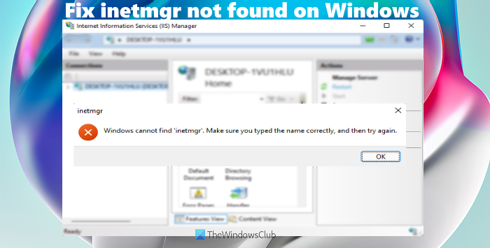

In this post, we will help you fix the issue where you may see a Windows cannot find inetmgr error message. InetMgr.exe is an executable file to launch the Internet Information Services (IIS) Manager application in Windows 11/10. You can use the Search box or Run Command box (using Win+R hotkey) and type inetmgr command to open the IIS Manager window. However, some users have reported that such command is not working on their Windows computers because either the InetMgr.exe file is missing or corrupted. If you are also facing the same problem, then this post might help.

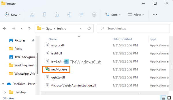

Where is InetMgr.exe located?
To locate the InetMgr.exe file, you need to follow this path:
C:\Windows\System32\inetsrv
Under the inetsrv folder, you will see the IIS Manager (InetMgr.exe) application file. However, if the InetMgr.exe file is not present there, then most probably it means that the IIS Manager application is not installed or enabled on your computer. Or, there could be some other reason for that. In such a situation, you first need to fix that issue to access the InetMgr.exe file. The solutions covered in this post will help you with that.

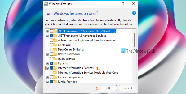

1] Enable IIS Manager using Windows Features
There are a lot of Optional Features of Windows for servers, business networks, etc. While some features are already turned on or enabled, others are not. It might be possible that IIS Manager is not enabled on your computer because of which you are facing this problem. So, you should enable IIS Manager using Windows Features. Here are the steps:
- Click on the Search box of your Windows 11/10 computer
- Type windows features
- Press the Enter key to open the Windows Features box. You might need to wait until all the features are loaded in that box
- Now locate and select the Internet Information Services option
- Click on the OK button. After this, Windows will start applying the changes
- Finally, restart your computer, and Windows will update your computer.
Now you should be able to use the inetmgr command to open the IIS Manager application.

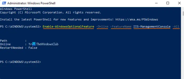

2] Enable IIS Manager using Windows PowerShell
You can also enable or install IIS Manager with the help of Windows PowerShell by running a single command. Follow these steps:
- Type powershell
- Right-click on the Windows PowerShell option
- Click on the Run as administrator option
- In the Windows PowerShell window, type and execute the following command:
Enable-WindowsOptionalFeature -Online -FeatureName IIS-ManagementConsole -All
After that, you might need to restart your computer. Now execute the inetmgr command and it might work.
