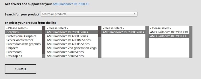

2] Reinstall the AMD GPU drivers using the AMD website
The next step is downloading the AMD GPU Driver from the AMD website. You can visit the AMD support website, select the GPU, and then choose to download the AMD drivers. The download page will offer you versions based on Windows or other platforms.
Once you have the setup file, run the installer with admin permission, and ensure a clean install.
