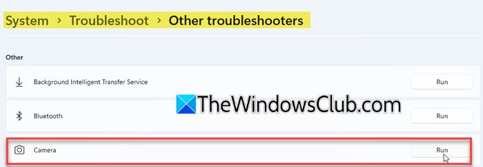

1] Run the camera troubleshooter
Start by running the Windows Camera troubleshooter. It is a built-in troubleshooter that can help detect and fix camera bugs automatically.
Click the Start button icon and select Settings. Go to System > Troubleshoot > Other troubleshooters and click the Run button next to Camera.
This will open the new Get Help Camera troubleshooter. Select Troubleshoot Camera in Windows 11. The troubleshooter will then recommend solutions and guide you through step-by-step instructions to identify and resolve the issue.

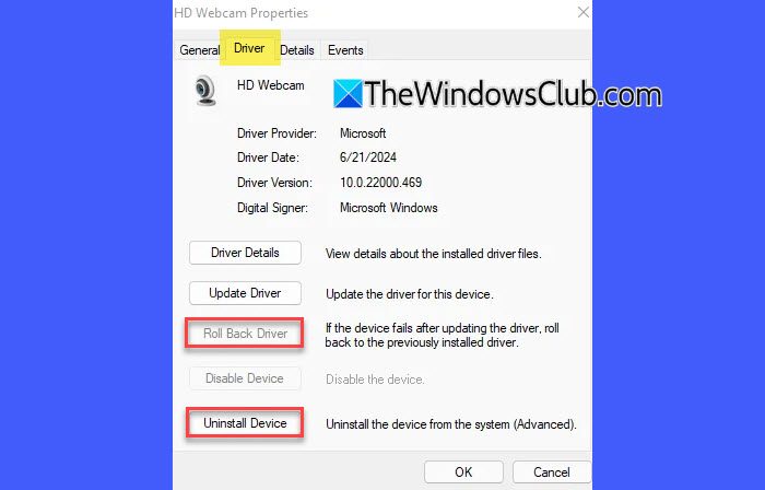

3] Roll back or reinstall camera driver
If the camera issue began after a recent Windows update, the update might have caused compatibility problems with the camera driver. Rolling back the driver reverts it to the previous version, which may have worked properly before the update. However, if rolling back isn’t an option, reinstall the driver.
Right-click the Start button and select Device Manager. In Device Manager, right-click your camera, and select Properties. Under the Driver tab, click Roll Back Driver (if the option is available), then follow the prompts. After the roll back is complete, restart your device, and then try opening the Camera app again.
To reinstall the camera driver, select Uninstall Device (under the Driver tab). Then select the check box for ‘Attempt to remove the driver for this device’ and click OK. Once the process completes, click the Action menu in Device Manager and select Scan for hardware changes. Wait for it to scan and reinstall updated drivers, restart your PC, and then try opening the Camera app again.

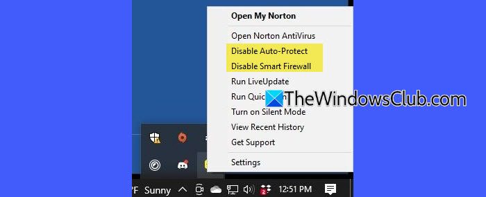

5] Disable antivirus temporarily
Antivirus programs often include privacy protection features that block access to the camera to prevent unauthorized usage. This can interfere with the Windows Camera app or specific modes, resulting in the scene switch failure.
To disable your antivirus, right-click the antivirus icon in the system tray and select ‘Disable’, ‘Pause protection’, or a similar option. If there’s no such option, open the antivirus program and look for the Settings or Protection section to disable it.
Make sure to re-enable it after testing the camera.
