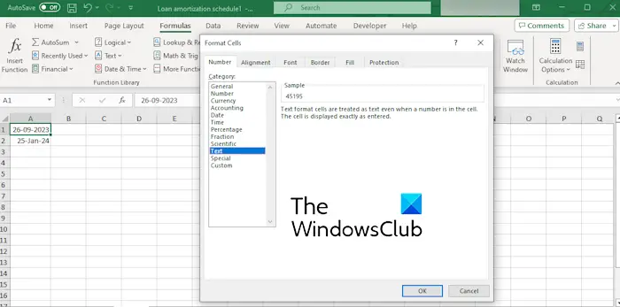

1] Format cells as text
The first thing you can do to prevent Excel from automatically changing a number to date is to change the format of problematic cells to text. Here are the steps to do that:
First, select all the problematic cells with numbers.
Next, right-click on the selected cells and choose the Format Cells option from the context menu. You can also press the CTRL+1 hotkey to open the Format Cells prompt.
Now, click on the Text category from the Numbers tab and press the OK button to save changes.
Once done, the issue will be resolved.

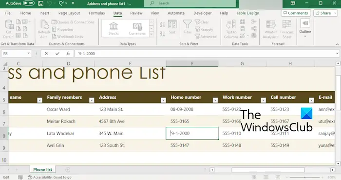

2] Insert an apostrophe before the number
You can also use an apostrophe before a number you want to enter in a cell. For example, if you want to add 9-7-2000 but it is getting changed to date 09-07-2000, you can add an apostrophe before the number like ‘9-7-2000. It will be shown as 9-7-2000.

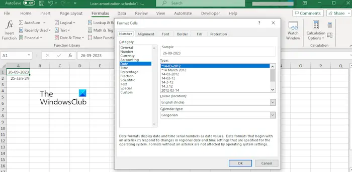

1] Set the format of cells to Date
If you have chosen an incorrect data format for cells where you want to insert dates, you will face this issue. So, make sure the cell format is set to Date. Here are the steps to do that:
- First, select all the cells with dates and press CTRL+1 to open the Formal Cells dialog.
- Now, click on the Date category from the Number tab.
- Next, you can select the date type, location, and calendar type to format dates in your workbook.
- Finally, click the OK button to save changes and see if the issue is fixed.

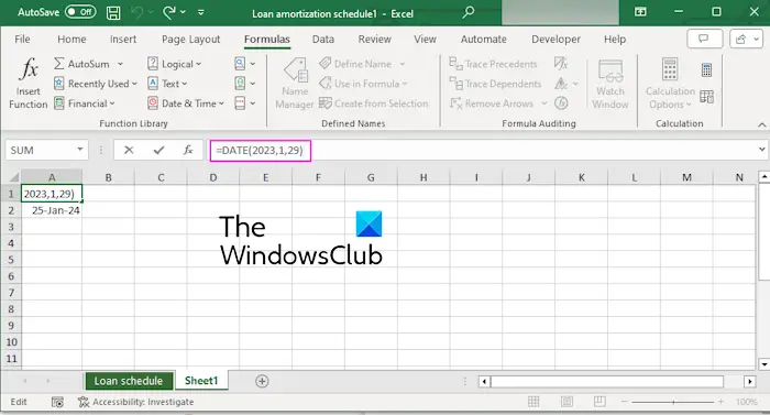

2] Use Date functions
Another thing you can do to fix this issue is to use Date functions to display dates in your Excel workbook. You can use syntax like =DATE(year,month,day) to do the same. For example, use =DATE(2024,2,14) to display the 14-02-2024 date in a cell.
