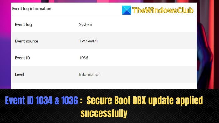

If you notice Event IDs 1034 and 1036 in the event log, there is nothing to worry about. The message says the Secure Boot DBX update was applied successfully, and Microsoft has fixed the issue.
Event ID 1034 or 1036: Secure Boot DBX update applied successfully
Event ID 1034: The cause of this informative event being logged is a confirmation that the Secure Boot DBX database has been updated successfully. Modifying or updating the untrusted Secure Boot components is aimed at enhancing system security by allowing the execution of only trusted software components during the boot process.
Event ID 1036: As suggested by the event message text, this particular event confirms the list of trusted certificates in Secure Boot DB has been updated successfully. This event notification is triggered when a new boot manager certificate is added to the list as the trusted one.
