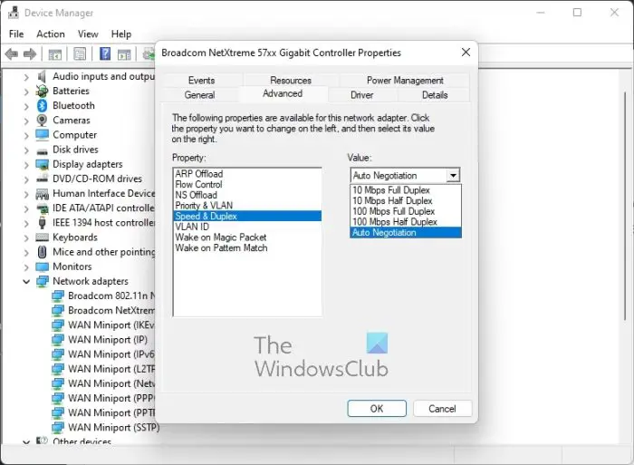

3] Configure the Speed and Duplex settings
Here’s the thing, Windows 11/10 comes with a feature known as Speed & Duplex. With this feature, the user can determine the speed of the Ethernet port. So, what if these settings experienced changes at some point? Let us discuss how to solve this.
- Click on the Search icon located on the Task Bar.
- Next, type Device Manager into the search box.
- From the Device Manager window, go to Network Adapters.
- Expand the Network Adapters section and right-click on the Ethernet adapter.
- Select the Properties option via the context menu.
- When a new window appears, please click on the Advanced tab.
- Look to the Property section and select Speed & Duplex from the list.
- Go to the dropdown menu under Value and select the appropriate speed.

If you want to enable 1Gbps on your Ethernet connection, then navigate to Device Manager, and from there, right-click on the Ethernet driver and select Properties. Now, from the Advanced tab area, please choose Speed & Duplex, then determine the speed you want via the Value area.
