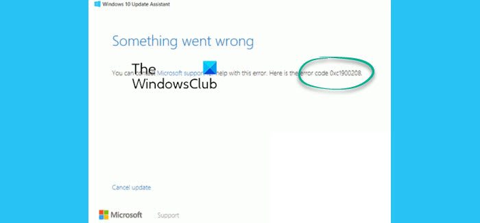

Windows upgrade process takes compatibility very seriously. They have to be compatible with the hardware and installed applications else the Windows Upgrade will get stuck. One of the error messages that show up is Windows Update error 0xC1900208 – 0x4000C. If Windows 11/10 will not upgrade due to Incompatible applications, then this post may help you.
Error 0xC1900208 – 0x4000C is caused due to app incompatibility. This indicates that an incompatible app installed on the PC is blocking the upgrade process from completing. You will have to ensure that all applications are up to date to the latest version and then check the compatibility. Else make sure that any incompatible apps are uninstalled and then try upgrading again. Do note that this is one of the error codes among many for compatibility issues that Windows Upgrade shows.

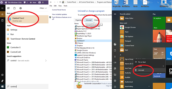

2] Uninstall software or application
If you downloaded it from the website, you would need to use the classic Program and Features to complete it.
- Type ‘control’ in the search box, and click on Control Panel (desktop app) when it appears.
- Select Program and Features from the list.
- This will list all the programs.
- Select the program which is possibly not compatible, and uninstall it.
If you have downloaded the application from the Windows Store, you can right-click on it from the application list and select uninstall.
