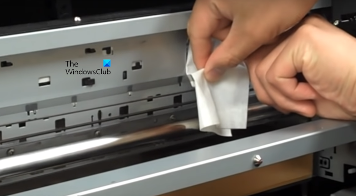

3] Clean encoder strip
A dirty encoder strip can also cause this error. The encoder strip is a thin, transparent strip of plastic that is located on the side of the carriage. Cleaning the encoder strip can resolve this error. To do so, use the following instructions:
- Turn off your printer.
- Open the printer cover.
- Locate the encoder strip.
- Gently wipe the encoder strip with a soft cloth or earbud.
- Close the printer cover and turn it on back.
Make sure you’re using a soft cloth, cotton, or earbud to clean your printer’s encoder strip. Check if the error is gone.
